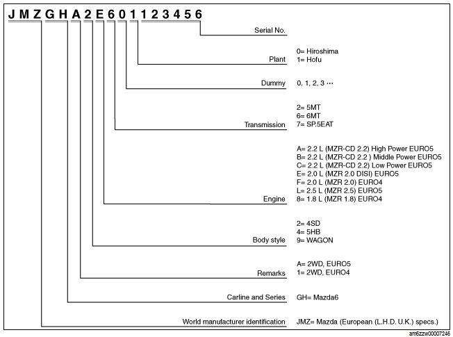

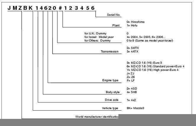

VIN çözümleri devamı aşağıda... Mazda3 ve 6 için...

This Miata was built in Japan, by Mazda.
It is a , with a 1.8 Liter, 4-cylinder turbo.
It was built in at the Hiroshima plant.
It was the 133,333rd Miata built in .
Country of Origin: J Japan
Manufacturer: M Mazda
Vehicle Type: Z
Miata Generation: BG
Body Style: 14
Engine Size/Type: 4 1.8 Liter, 4-cylinder turbo
Check Digit: 3 Check digit, has no meaning.
Model Year: 0
Manufacturing Plant: 0 Hiroshima
Series Number: 233333 133,333rd in .
